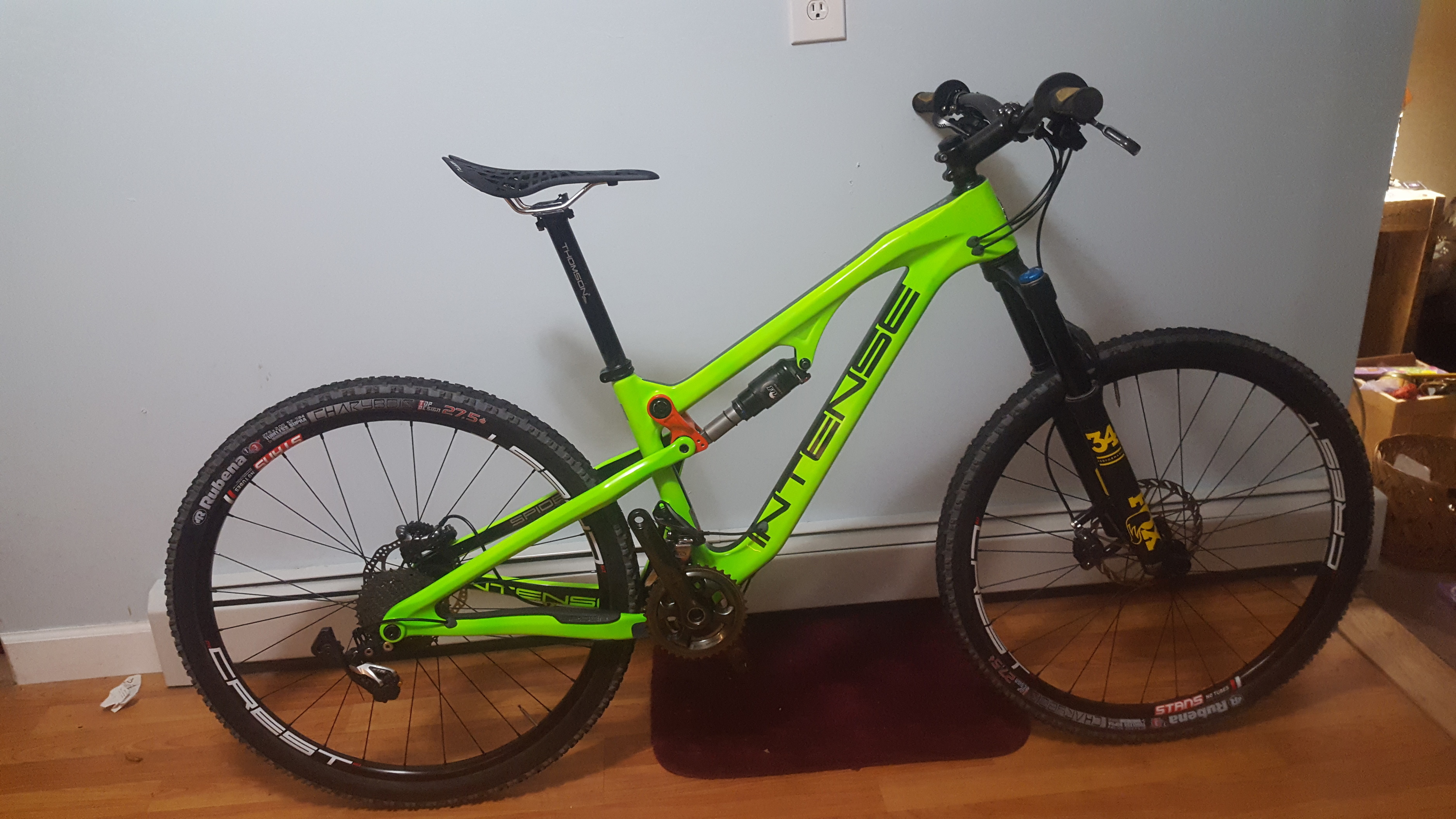

Its coming along. Everything is failling into place. Its not as light as I would like… feel factory is about 23 lbs. Big savings was the wheels
Looks sweet. I like the weight saving seat.
believe it or not. the seat is actually very comfy. Lotta time…and money went into this thing!!!

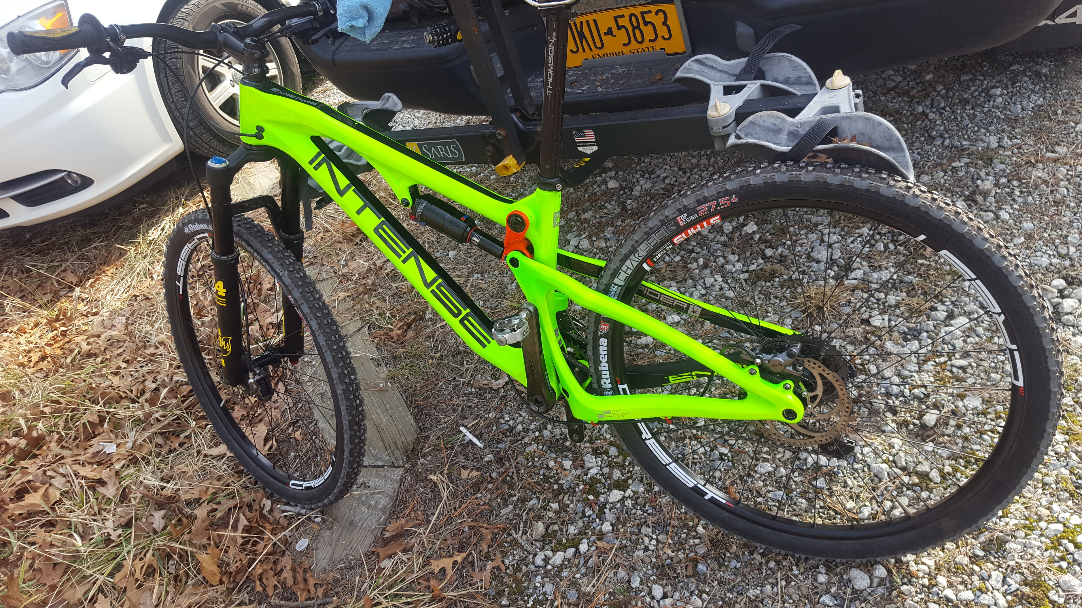

Took it out too overton today
The only thing that didnt come in yet is the cassette… so the old one was used.
Talk about pop corn… holy smokes. There was only 2 gears that were useable. The big chain wheel is a 38 and little is a 24 I believe.
Gearinis perfect in the back (34/11 10sp)… but… it pops.
Almost everything is new… the fork is way stiffer than the old 32mm … the bike feels light and agile and… to my surprise stiffer than i expected.
Maybe its the boost spacing on the wheels… which i can definately notice.
Awaiting the new cogs then i am done.
I think i am into it for about 3 to 35 less the frame… yeah… they said switch over most of the parts… ha ha ha
Everything is new… less bars, stem. Shifters and rear derailluer… ha ha ha
These tires do not work well on Florida Trails.
Too skinny… need something a little Fatter to glide thru the sand. They also Knife in the corners… time to upgrade

These tires were kicking on Long Island. But here, they dont float on the sand. also on the carpet and trail lining theycut right in… not fun. Feels like a whole ride of climbing
Went up too 2.2 tires. Maxxis IKON… what a difference… OMG! no more Knifing and floats thru the sandy sections better. What was I waiting for!
